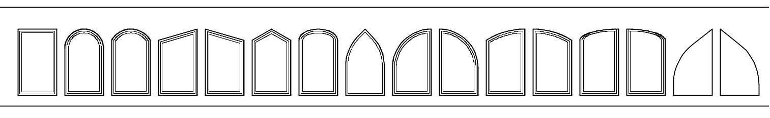

Top Shape: This dropdown determines the window's top shape. The choices are
  • Square
  • Round
  • Segment
  • Sloped from Left
  • Sloped from Right
  • Gable
  • Ellipse
  • Gothic
  • Half Round from Left
  • Half Round from Right
  • Half Segment From Left
  • Half Segment From Right
  • Half Ellipse From Left
  • Half Ellipse From Right
  • Half Gothic From Left
  • Half Gothic From Right
ⓘ For some shapes, you will need to enter a suitable rise; you may also want to enter a spring value. If a transom or fanlight is applied, it will take the shape, and the mullion and sash below will be square.
Example Window Top Shapes

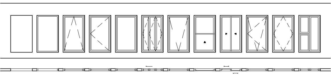

Insert Relative To: This dropdown determines whether the window's insertion is relative to the exterior face, center, or interior face of the window's frame.
Configuration: This dropdown lets you choose the window's configuration from a list of available options. Alternatively, you can check the Use symbol geometry checkbox (just below the Rise and Spring fields above) to use a custom symbol.
The available window configurations are
  • Opening
  • Cased Opening
  • Awning (US), Top Hung Casement (UK)
  • Casement
    • Single
    • Bi-part
  • Fixed Glass
    • Sash
    • No Sash
  • Folding
  • Hopper (US), Bottom Hung Casement (UK)
  • Hung
    • Single Hung
    • Double Hung
  • Sliding
    • various configurations, X = Window, O = Panel (XO shown)
    • Picture Window Slider
  • Tilt/Turn
  • Vertical Pivot
  • Custom
Some configuration choices will prompt additional parameters, such as Open Direction, Hinge Side, and Left/Right Sash Number.
Example Window Configurations
